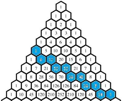

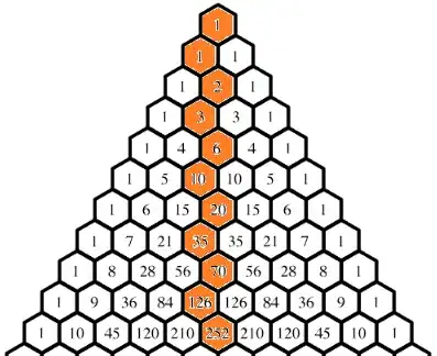

Here is an example with a triangle with $10$ rows (the top $1$ is row $0$):
$1\cdot 1\cdot 2\cdot 3\cdot 6\cdot 10\cdot 20\cdot 35\cdot 70\cdot 126\cdot 252=560105280000$
$1\cdot 6\cdot 15\cdot 35\cdot 35\cdot 56\cdot 28\cdot 36\cdot 9\cdot 10\cdot 1=560105280000$

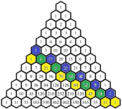

In the diagram,
$P_o(10)$ is the product of the numbers in blue and green.
$P_o(11)$ is the product of the numbers in yellow and green.
$\begin{align} \dfrac{P_o(11)}{P_o(10)}&=\dfrac{\binom{6}{0}}{\binom{5}{0}}\cdot\dfrac{\binom{7}{2}}{\binom{6}{2}}\cdot\dfrac{\binom{8}{4}}{\binom{7}{4}}\cdot\dfrac{\binom{9}{6}}{\binom{8}{6}}\cdot\dfrac{\binom{10}{8}}{\binom{9}{8}}\cdot\dfrac{\binom{11}{10}}{\binom{10}{10}}\\ &=\dfrac{6}{6}\cdot\dfrac{7}{5}\cdot\dfrac{8}{4}\cdot\dfrac{9}{3}\cdot\dfrac{10}{2}\cdot\dfrac{11}{1}\text{ because }\dfrac{\binom{p}{r}}{\binom{p-1}{r}}=\dfrac{p}{p-r}\\ &=\binom{11}{5}\\ &=\dfrac{P_v(11)}{P_v(10)}\\ \end{align}$
Or in general,
$\begin{align} \dfrac{P_o(2n+1)}{P_o(2n)}&=\prod\limits_{k=0}^n \dfrac{\binom{n+1+k}{2k}}{\binom{n+k}{2k}}\\ &=\prod\limits_{k=0}^n \dfrac{n+1+k}{n+1-k}\\ &=\binom{2n+1}{n}\\ &=\dfrac{P_v(2n+1)}{P_v(2n)}\\ \end{align}$
A similar argument shows that $\dfrac{P_o(2n)}{P_o(2n-1)}=\dfrac{P_v(2n)}{P_v(2n-1)}$.
$\therefore\dfrac{P_o(a+1)}{P_o(a)}=\dfrac{P_v(a+1)}{P_v(a)}$ for all $a\in\mathbb{N}$.
