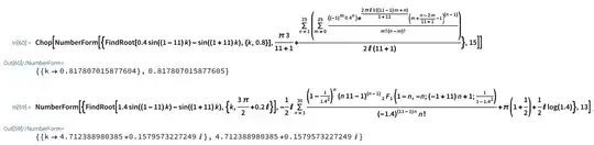

The series for the complex roots sum converges for about $|b|<1$ while the one for the real roots converges for about $|b|>1$ shown here:
Note the sum of index $m$ can have an upper bound of $\infty$ and both sums are interchangeable. If one really wanted, any one of the two sums over $m,n$ has a Fox Wright function form.
