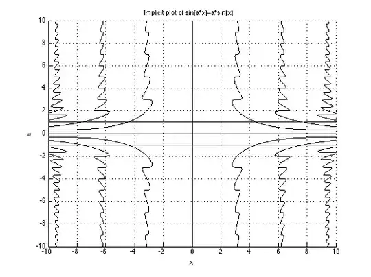

  • I doubt there will be a closed-form formula for these curves... https://i.sstatic.net/2jlSI.png ($x$ on the $x$-axis, $a$ on the $y$-axis, both between $0$ and $4\pi$) –  Jul 12 '13 at 02:52

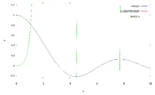

Ploting $\frac{\sin x}{x}$ vs $x$, one immediately see that $(*1)$ doesn't have any solution for $|x| <$ some $x_c \sim 2.777068336$. $x_c$ is a root of the equation:
$$\frac{\sin x}{x} = \frac{1}{\sqrt{1+\beta^2}} \sim 0.128374554$$ where $\beta \sim 7.725251837$ itself is a root of another equation $\tan \beta = \beta$.
sin(x)/x

This is not intended to really answer the question, but I think it is appropriate to add as an answer.
An implicit plot of the values for $a$ and $x$ which satisfy the given relation is shown below. Clearly, there are solutions for rational $a$ values, but a closed form solution for $x$ is likely difficult for arbitrary $a$, given the previous answers to this question.
Implicit plot of $\sin(ax)=a\sin(x)$
