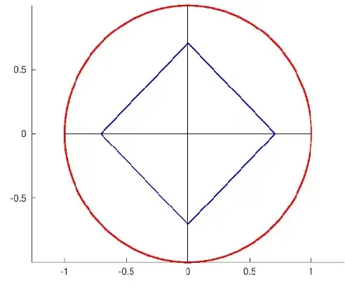

This problem deals with the boundary of the intersection of the disk $D(P,1)$ with center $P$ and radius 1 and the (filled) square $C$.
Let us give a complete treatment of the particular case where $P$ is at the center of the square ; in this case this frontier is the square itself with the following polar equation (see this answer) :
$$r = \frac{1/2}{|\cos(\theta-\pi/4)|}$$
(the square being with vertices $(\pm s;0), \ (0; \pm s)$ (where $s:=\tfrac{\sqrt{2}}{2}$) as can be seen on the graphics below :
The mean length is therefore obtained as :
$$\overline{L}= \frac{1}{2 \pi}\int_0^{2 \pi} \frac{1/2 \ d \theta}{|\cos(\theta-\pi/4)|}$$
Taking into account different symmetries, it suffices to work in the first part of the first quadrant and multiply the result by $8$ ; this allows in particular to drop the absolute value signs :
$$\overline{L}= \frac{1}{2 \pi} 8 \int_0^{\pi/4} \frac{1/2 \ d \theta}{\cos(\theta-\pi/4)}=\frac{2}{ \pi} \int_0^{\pi/4} \frac{d \theta}{\cos(\theta)}\tag{1}$$
Knowing that a primitive function of $\frac{1}{\cos(\theta)}$ is $\ln \left(\frac{1+\tan(\theta/2)}{1-\tan(\theta/2)}\right)$ and that $\tan \tfrac{\pi}{8}= \sqrt{2}-1$, a closed-form value can be given to (1).
