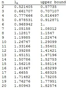

For example, for $2 \leq n \leq 20$ we have
