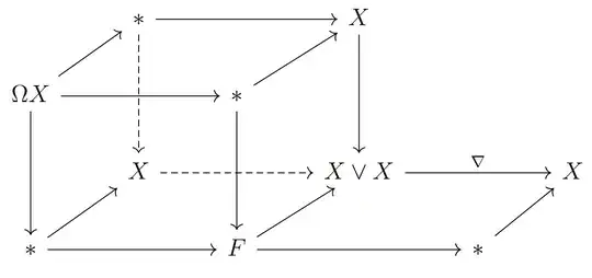

In that case, we write $F$ for the homotopy fiber of $\nabla$, and can form the following diagram: enter image description here
All squares going from the front to the back are homotopy pullbacks. Indeed, the right-bottom square is a homotopy pullback by definition of $F$, and via pasting lemmas it then follows for the left-bottom square and middle-vertical square. The leftmost vertical square and the left-upper square are both homotopy pullbacks as this is (essentially) the definition of $\Omega X$.
If $X$ is well-pointed, then the (edit:) back square is a homotopy pushout. Now, the cube theorem states that if the back square of a cube is a homotopy pushout of spaces, and if all squares going from the front to the back are homotopy pullbacks, then the front square of the cube is also a homotopy pushout. Hence we find that $F$ is the homotopy pushout of the span $*\leftarrow\Omega X\rightarrow *$. Again, (essentially) by definition, this homotopy pushout is $\Sigma\Omega X$, so $F\simeq \Sigma\Omega X$.
