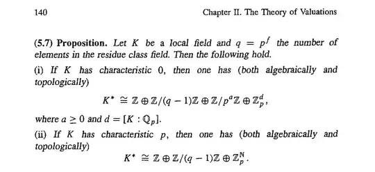

Q.1. I don't understand these statements. Here, $(5.7)$ Proposition is,
Note that $(\pi) \cong \mathbb{Z}$ and $K^* = (\pi) \times U$ as I mentioned above. Perhaps, $\mu(K) \cong \mathbb{Z}/(q-1)\mathbb{Z} \oplus \mathbb{Z}/p^a\mathbb{Z}$ when $\operatorname{char}K=0$ and $\mu(K) \cong \mathbb{Z}/(q-1)\mathbb{Z}$ when $\operatorname{char}K =p $ ? If so, then we can show the above isomorphism.

$Q_1$: Also true. To see a proof of the stated isomorphisms, look here Units of p-adic integers.
