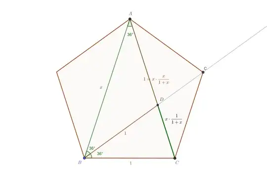

For diversity, here is a geometrical argument, which should be accesible to a lower level. Consider the isosceles triangle $\Delta ABC$ with side $BC=1$, $AB=AC=x$, and an angle of $36^\circ$ in $A$. The angle bisector in $B$ intersects $AC$ in $D$.
computing sin 18 with geometric means
Then shown angles put in evidence the isosceles triangles $\Delta DAB$ and $\Delta BCD$. This gives $AD=BD=BC=1$. On the other side, the side $AC=x$ is cut in $D$ in two segments that respect the proportion $AD:DC=BA:BC=x:1$, which leads to $AD=x\cdot x/(1+x)$, $CD=x\cdot 1/(1+x)$. We obtain an equation for $x$, $$1=AD=\frac {x^2}{1+x}\ ,$$ with the positive solution $x=\frac 12(1+\sqrt 5)$. Draw now the angle bisector from $A$, for each of the formed angles of $18^\circ$ we have then in each of the formed right triangles with hypotenuse $x=AB=AC$: $$ \sin \frac\pi{10} =\sin 18^\circ = \frac{1/2}x=\frac{1/2}{(\sqrt5+1)/2} =\frac 1{\sqrt 5+1} =\frac {\sqrt 5-1}{5-1}= \bbox[yellow]{\ \frac 14(\sqrt 5-1)\ }\ . $$
