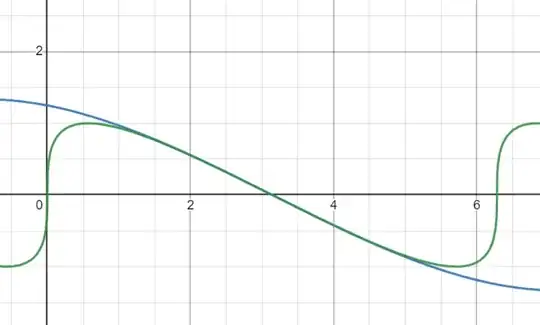

Green graph is y=sin(x+y) and blue graph is the approximation

    You can calculate $f(x)$ in a very simple way: Take $a_0 = 00$ and $a_{n+1} = \sin(x + a_n)$.Then $f(x) = \lim_{n\to\infty} a_n$. In other words, begin at $0$ (or in any other real number) and iterate the function $u \mapsto \sin(x+u)$. In practice you would get an approximation to $f$ after a few iterations, and you can keep iterating until you have the desired precision. – jjagmath Oct 14 '23 at 02:44
  • Ok, but we can make a series for the function? – tzk Oct 14 '23 at 02:53
Use the Taylor series $$\sin ^{-1}(y)-y=\sum_{n=1}^\infty\frac{ (2 n)!}{4^{n}(2 n+1) (n!)^2}y^{2n+1}$$ and then power series reversion.
You should end with $$y=\sum_{n=0}^\infty a_n\, t^{2n+1} \qquad \text{where} \qquad \color{red}{t=\sqrt[3]{6x}}$$ the first coefficients being $$\left\{1,-\frac{3}{20},\frac{1}{1400},\frac{1}{25200},\frac{43}{1724 8000},\frac{1213}{7207200000},\frac{151439}{12713500800000},\cdots\right\}$$
You can generate as many as you wish using the explicit formula for the $n^{\text{th}}$ term given by Morse and Feshbach.
If you use the above terms and plug them in the original equation, you would find $$x=x-\frac{8074161\ 3^{2/3}}{1191190000000 \sqrt[3]{2}}x^{17/3}+\cdots$$
Use it for $x=\frac 14$; this would give $y=\color{red}{0.9212296}45$
