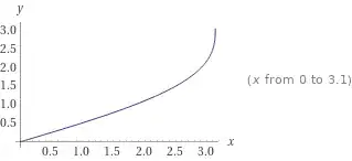

Here is a numerical tester for the inverse function
Here is a plot of:
$$\boxed{x=\sin(y)+y\implies y=\text E(-1,x) = \text{hav}^{-1}\left(\text I^{-1}_{\frac x\pi}\left(\frac12,\frac32\right)\right),0\le x\le \pi}: $$
The code is inversehaversine(inversebetaregularized(x/pi,1/2,3/2))
where appears the Inverse Haversine, a transformed inverse sine function.

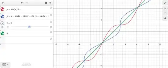

Using the fixed-point technique seems to be the simplest solution I found:
$y = x - \sin(y)$
$y = x - \sin(x - \sin(y))$
$y = x - \sin(x - \sin(x - \sin(y)))$
$y = x - \sin(x - \sin(x - \sin(x - \sin(x - ... \sin(y) ...))))$
You can assign any value to $y$ on the right side since the effect is eventually eliminated after numerous iterations of the sine operation.
Here are the plotted functions, where the $z$ slider represents the $y$ value on the right side of the equation:
sin(x) + x inverse
As observed, the source and inverse functions exhibit symmetry with respect to the line $y = x$.
