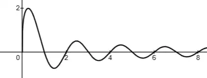

Consider the curve $y=\frac{\sin (\pi x)}{x^p}, x>0$, shown here with $p=0.75$.
It occurred to me that if $p$ is large enough, then the curve flattens quickly, so the arc lengths between neighboring roots approach $1$ quickly, so the product of all those arc lengths should converge.
So my question is:
For what values of $p$ does the product of all the arc lengths between neighboring roots exist?
That is, given $f(x)=\dfrac{\sin (\pi x)}{x^p}$, for what real values of $p$ does the following limit exist:
$$L=\lim_{n\to\infty}\prod_{k=1}^n \int_{k}^{k+1}\sqrt{1+(f'(x))^2}dx$$
Numerical investigation suggests that when $p=1$, $L\approx 4.93$; and when $p=0.5$, $L$ does not exist. If that's true, then there must be some critical value of $p$ between $0.5$ and $1$, and I wonder what it is.
