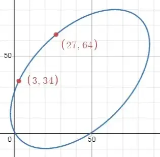

Update: (Jan 22, four months later)
Courtesy of an insight by Adam Bailey in this post, given $x^3+y^3+z^3=(z+1)^3$ we now realize that $(x,y)$ of Family 2 and 3 are just lattice points on the same ellipse. Do the substitution, $z = (k + 1)(x - 1) + k y\,$ where $k = \dfrac{3n^2+1}{3n}$ and, after removing a trivial factor, we get the ellipse,
$$3n^2(x^2 - xy + y^2) - (1 + 6n + 12n^2 + 18n^3 + 9n^4)x - (1 + 3n^2 + 9n^4)y + (1 + 3n + 9n^2 + 9n^3 + 9n^4) = 0$$
where two lattice points are $(x_1, y_1)$ and $(x_2, y_2)$ from Family 2 and 3, respectively. For example, let $n=3$ so,
$$27(x^2 - x y + y^2) - 1342x - 757y + 1063 = 0$$
which for this $n$ has only 2 lattice points,
thus we can use these coordinates,
$$27^3 + 64^3 + 306^3 = 307^3\;\\ 3^3 + 34^3 + 114^3 = 115^3$$
and so on for infinitely other $n$.
