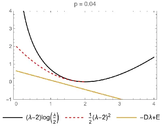

Addendum. Just for fun, I also included an animated figure demonstrating a variant of $\text{(2)}$,
$$(\lambda - 2)\log(\lambda/2) \geq - D \lambda + E$$
as functions of $\lambda$, for various values of $p$:
