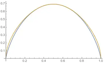

Firstly rewrite this expression as $$ x + y- \sqrt{xy} \le x^{\frac{x}{x+y}} \cdot y^{\frac{y}{x+y}}. $$ Then one can use a substitution $$ a = \frac{x}{x+y}, \; b = \frac{y}{x+y} $$ and get an equivalelent inequality in terms of $a$ and $b$ $$ (1 - \sqrt{ab}) \le a^a b^b, \;\; a +b = 1. $$ So, we need to show that given $a+b = 1$, we will have $$ \sqrt{ab} + a^a b^b \ge 1. $$ It's equivalent to the following upper bound for Shannon entropy $H(a,b)$ $$ H(a,b) = -a \log a - b\log b \le -\log(1-\sqrt{ab}), \;\; a+b=1. $$
So, one needs to prove this estimate for Shannon entropy $H(a,b)$. Unfortunately, I have no idea how to do this without calculus. Plots of $H(a,b)$ and its upper bound:
It might happen that this inequality has some meaning in information theory, though I haven't found anything about that.
