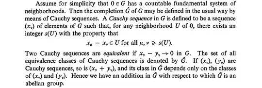

Paraphrasing Atiyah, MacDonald, Introduction to Commutative Algebra, Chapter 10, p. 102: let $G$ be a topological abelian group. Then:
I understand everything what is on this excerpt. Also, the set $\hat{G}$ has a topology explained here. My question is: with this topology, is $\hat{G}$ a topological group? On the one hand, if we denote $\hat{U}\subset \hat{G}$ to the open subset induced by an open subset $U\subset G$, then one has $-\hat{U}=\widehat{-U}$, so I am actually asking:
Is the sum operation $\hat{G}\times\hat{G}\to\hat{G}$ continuous?
