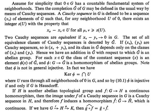

Update: I am essentially wondering why Atiyah-Macdonald restrict themselves to groups where $0$ has a countable neighborhood basis when talking about these concepts. Let's include a picture:

    @AlexP. The reason is that they later want to describe the completion using sequences, I think. The completion of a general topological group is a bit of a mess. – Martin May 06 '13 at 22:28
  • @Martin I included the relevant picture in my original post. I really don't see where the first countability hypothesis simplifies anything, though. We can simply define the completion as the set of equivalence classes of Cauchy sequences. – Alex Provost May 06 '13 at 22:30
    @AlexP. Yes, I think you can give a meaningful definition for every topological abelian group, as you suggested. The resulting group should be sequentially complete (I haven't checked). However, completeness of a uniform space is a stronger requirement than just sequential completeness. Probably their choice is a mixture of two things: avoid technicalities with uniform spaces and cover the interesting situations for the applications they have in mind. – Martin May 06 '13 at 23:00
The reason why Atiyah and MacDonald restrict to first-countable topological abelian groups is because otherwise to construct the completion one would need to use the theory of filters (and other things I haven't ever studied, see Bourbaki, General Topology, Chap. III, §3), in which case it is “a bit of a mess,” as Martin said on a comment in Berci's answer.
One leverages the first-countability property to allow $\hat{G}$ to be set-theoretically described as the set of Cauchy sequences in $G$ modulo the equivalence relation stated on the screenshot from the OP. If you want to see the first-countability hypothesis in action, one actually needs to invoke it to show that
