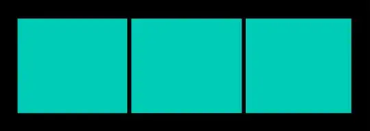

21 tromino tiles (three squares glued together in a row) can together cover 63 squares on an $8 \times 8$ grid. One of the squares thus becomes non-covered. What are the possible positions where the empty square can be?
If this is the relevant object to consider, and it should be arranged only horizontally, being an odd number, it cannot fill any row in the 8x8 grid, without leaving 2 squares unfilled. These two squares are left unfilled for each row, and can be filled by putting a tile on ever row on the empty remaining 2 squares. This leaves one square of the tile outside the 8x8 grid. How can the question assume that 63 squares are filled out of 64, when this combination covers all 64?

    Why do you think it can only be arranged horizontally? Nowhere in the question does it say it cannot be arranged vertically. – Adam Rubinson Jul 24 '23 at 14:36
  • @AdamRubinson because it says "thee squares glued in a row", and since it does not impose you to put it vertically and horizontally as you say, then why not all horizontally? – Superunknown Jul 24 '23 at 14:37
    I suspect they do not intend "row" to mean "horizontal" in this context. "In a row" means, "adjacent and in a line" (rather than some other arrangement that can be made from three squares). – Adam Rubinson Jul 24 '23 at 14:38
    @Luthier415Hz For me tt's quite obvious, from the question, that the tile can be rotated. – leonbloy Jul 24 '23 at 14:39
    So you assume that the tromino can go outside of the $8\times 8$ grid? How interesting – acat3 Jul 24 '23 at 14:47
