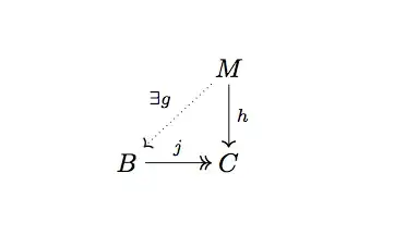

  2. A natural question is: When does $\operatorname{Hom}(M,-)$ send short exact sequences to short exact sequences? In other words, when is $j_\ast = \operatorname{Hom}{(M,j)}$ an epimorphism for all short exact sequences $0\; \xrightarrow{\phantom{ij}} \; A \; \xrightarrow{i\phantom{j}}\; B\; \xrightarrow{j\phantom{i}} \; C \to 0$?
    In view of left exactness of $\operatorname{Hom}{(M,-)}$ the question is: Given any morphism $h: M \to C$ and any epimorphism $j: B \to C$, when is $h$ of the form $h = j_\ast g$ for some morphism $g: M \to B$?
    Lifting property
    As you certainly know, this is precisely the definition of projective modules: $M$ is called projective if and only if $g$ always exists, for all epimorphisms $j: B \twoheadrightarrow C$ and all $h: M \to C$. For emphasis:
    A module $M$ is projective if and only if $\operatorname{Hom}{(M,-)}$ is exact, that is: it sends short exact sequences to short exact sequences.
