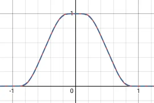

Maybe the derivative $R'(x)$ of the Rvachëv function works as an example of what you ask in the last part of your edit:
It fulfills $$R'(x)=2R(2x+1)-2R(2x-1)$$ in the whole real line, but the function is defined as: $$R(x)=\begin{cases} 0,\quad |x|\geq 1\\ F(x+1),\ \text{otherwise} \end{cases}$$ with $F(x)$ the Fabius function, which is "an example of an infinitely differentiable function that is nowhere analytic".
So you have a "well behaved function" since is a smooth bump function, but which closed-form formula is unattainable (I believe).
In this answer there is a clever way to approximate the function through piecewise polynomials, but as a "gross approach" of how it looks like (for having a general idea), it looks pretty close to $$q(x)=\begin{cases} 1,\quad x=0\\ 0,\quad |x|\geq 1\\ \dfrac{1}{1+\exp\left(\dfrac{1-2|x|}{x^2-|x|}\right)},\ \text{otherwise}\end{cases}$$ both here in Desmos. approximations to the Rvachëv function
and if it don't work, since $q(x)$ is also a smooth function, I don't believe there is going to be a closed form for $$h(x)=\int\limits_{-\infty}^{x}q(y)\ dy$$ which be also a well-behaved smooth transition function, which could be aproximated through a power series, but a non-piecewise power series will never match it since it has a constant value in a non-zero measure interval (it will violate the Identity theorem for power series).
