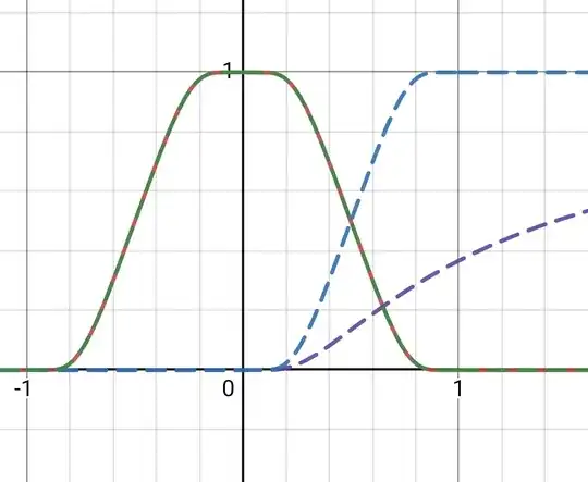

Is the function $$q(x)=\begin{cases} 1& x=0\\ 0& |x|\geq 1\\ \dfrac{1}{1+\exp\left(\dfrac{1-2|x|}{x^2-|x|}\right)}&\text{otherwise}\end{cases}$$a smooth function class $C^\infty(\mathbb{R})$?
I found this function as is shown in Wiki by choosing $f(x)=\exp\left(-\frac{1}{x}\right)\theta(x)$ with $\theta(x)$ the Heaviside step function, then making $g(x)=\frac{f(x)}{f(x)+f(1-x)}$ and then lets $q(x)=g\left(\frac{x-a}{b-a}\right)\cdot g\left(\frac{d-x}{d-c}\right)$ with $a=-1,\ b=c=0,\ d=1$, as could be seen in Desmos.
composition example
But later in this question I found in the answers and comments it have some issues at specific points were is undefined, so now I tried to fix them by defining the function piecewise.
A simular construction is used in this answer in MSE to built an example of a smooth transition function so in the case of this $q(x)$, in principle, the points were could be some issues should be only $x\in\{-1, 0,1\}$, but since its defined piecewise now I am not sure if indeed this solve the situation making $q(x)\in C^\infty(\mathbb{R})$ a smooth function, or it still have issues that make it being non infinitely differentiable.
I was able to check it possitively until the 7th derivative in Wolfram-Alpha.
