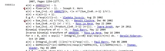

The integer sequence A007526 is a sequence with many equivalent formulations. I have noticed the following expression, which seems to be correct. However, I am not sure how to prove it.
Prove that $$\sum_{k=1}^n k! \cdot \binom{n}{k}=\lfloor e \cdot n! - 1 \rfloor$$
