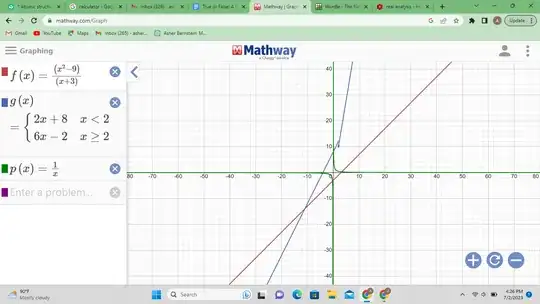

The function that you showed is not continuous because it looks like two separate lines which don't ever connect. There are three main types of discontinuity: point, jump, and infinite. Point discontinuity, as said in the name, is when a function is not defined for a point. Jump discontinuity is the type of discontinuity your piecewise function has. The function jumps from one point to another. Infinite discontinuity is when a function has one or more asymptotes. Here are all three examples of discontinuity. enter image description here
