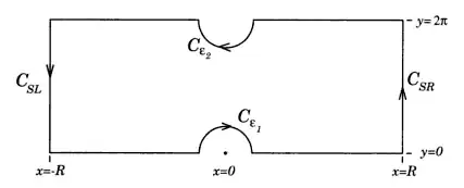

You may indeed use contour integration as nicely exposed in Ablowitz and Fokas "Complex Variables" p. $244$.
The idea is to evaluate $\;\displaystyle I(p):=PV \int_{-\infty}^\infty \frac {e^{px}}{1-e^x}dx,\quad(0<p<1)\quad$ using the contour :
contour
The integrals at the right and left side vanish as $R\to +\infty$ and the four bottom and top horizontal lines will add the contribution : $$\left(\int_{-R}^{-\epsilon_1}+\int_{\epsilon_1}^R\right)\frac{e^{px}}{1-e^x}dx+e^{2\pi ip}\left(\int_{R}^{-\epsilon_2}+\int_{\epsilon_2}^{-R}\right)\frac{e^{px}}{1-e^x}dx$$ that is (as $\;R\to +\infty$ and $\epsilon_i\to 0$) : $$\tag{1}\left(1-e^{2\pi ip}\right)PV \int_{-\infty}^\infty \frac{e^{px}}{1-e^x}dx$$while the semi-circular contours will give, as $\epsilon_1 \to 0^+$ and $\epsilon_2 \to 0^+$ :
\begin{align} \tag{2}\lim_{\epsilon_1\to 0}\int_{C\epsilon_1}\frac{e^{pz}}{1-e^z}dz&=-i\pi\left(\frac{e^{pz}}{-e^z}\right)_{z=0}=i\pi\\ \tag{3}\lim_{\epsilon_2\to 0}\int_{C\epsilon_2}\frac{e^{pz}}{1-e^z}dz&=-i\pi\left(\frac{e^{pz}}{-e^z}\right)_{z=2\pi i}=i\pi\,e^{2\pi i p}\\ \end{align}
Since no singularity appears in its inside the whole contour will have an integral of value $0$ equal to the sum of $(1),\;(2)$ and $(3)$. This gives : $$I(p)=PV \int_{-\infty}^\infty \frac {e^{px}}{1-e^x}dx=-i\pi \frac{1+\,e^{2\pi i p}}{1-\,e^{2\pi i p}}$$ or simply : $$\tag{4} \boxed{\displaystyle I(p)=\pi \cot( \pi p)}$$ Now $(4)$ multiplied by $p$ should give Euler's generating function for $\zeta($even$)$ : $$\tag{5}\displaystyle\pi\;p\;\cot(\pi\;p)=1-2\sum_{n=1}^\infty \zeta(2n)\;p^{2n}$$ which allows to find $\zeta(2n)$ just by using the expansion of $\pi\,x\;\cot(\pi\,x)$ : $$\tag{6}\pi\,x\;\cot(\pi\,x)=1-2\left(\frac {\pi^2}6x^2+\frac{\pi^4}{90}x^4+\frac{\pi^6}{945}x^6+\cdots\right)$$

  • Dear Raymond, Maybe I could please ask you to elaborate as to how you get (2) & (3). I know you showed how for the half circle you get "half" a residue here http://math.stackexchange.com/questions/478534/two-questions-regarding-mathrm-li-from-edwards. But that example is in a nice convenient form with the $\frac{C_{-1}}{z-z_0}$ of a Laurent series. So how do you get the terms in the ( ) in each of (2) and (3)? I tried using $z = \epsilon e^{i \theta}$, but that got pretty messy and is far from the simplicity of your terms. Also looked at the link in Ron's blog where he uses $z$ as I mentioned –  Feb 18 '14 at 21:58
  • so am unable to get his results as well. Thanks very much for your consideration. All the best, –  Feb 18 '14 at 21:59
    @96Tears: Hi Andrew. We have two clockwise semi-circular contours so that the residue formula $,\displaystyle 2\pi i \sum_j \operatorname{Res}\left(\frac {N(z)}{D(z)};z_j\right)$ becomes $,\displaystyle-\pi i \operatorname{Res}\left(\frac {N(z)}{D(z)};z_0\right)$. Now $N(z):=e^{p,z}$ and $D(z):=1-e^z$ are both analytic at $z_0=0$ (or $z_0=2\pi i$) with $D(z)$ having a zero of order $1$ at $z_0$ (i.e. $\displaystyle D(z)=(z-z_0)D'(z_0)+\frac {(z-z_0)^2}{2!}D''(z_0)+\cdots$). The residue will then be $,\displaystyle \frac {N(z_0)}{D'(z_0)}=\frac {e^{p,z_0}}{-e^{z_0}}$ as wished. Cheers, – Raymond Manzoni Feb 19 '14 at 00:19
