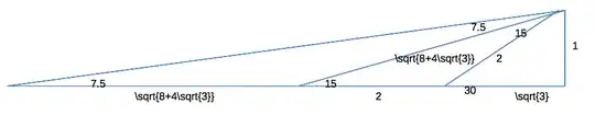

Here is an elementary (almost without words) proof that does not rely explicitly on half-angle or double-angle formulas. What is used is the fact that $\cot(30^\circ) = \sqrt{3}$, the exterior angle theorem, isosceles triangle theorems and Pythagorean theorem of Euclidean geometry, and the fact that $8 + 4\sqrt{3} = \left(\sqrt{2}+\sqrt{6}\right)^2$ (cf. Robert Israel's answer). The crude, not-to-scale, diagram below is, I hope, self-explanatory especially if you start from the right side and work your way to the left.
The length of the base of the triangle is $$\cot(7.5^\circ) = \sqrt{8+4\sqrt{3}} +2+\sqrt{3} = \sqrt{2}+\sqrt{6} + \sqrt{4}+\sqrt{3}$$
