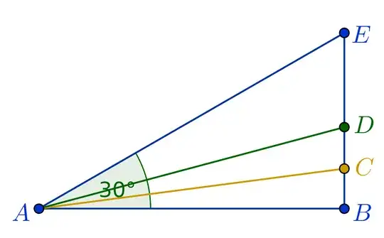

You may prove that identity in a very geometric flavour, i.e. by bisecting twice a $30^\circ$ angle, through the Pythagorean theorem and the bisector theorem. It is best to keep the expressions of the involved lengths as simple as possible during the process. So, let we consider a triangle $BAE$ with $BA=\sqrt{3}, AE=2, EB=1$. Let $AD$ be the bisector of $\widehat{BAE}$ and $AC$ be the bisector of $\widehat{BAD}$. enter image description here
By the bisector theorem, we have: $$ BD = \frac{\sqrt{3}}{2+\sqrt{3}} = 2\sqrt{3}-3. \tag{1}$$ By the Pythagorean theorem, it follows that: $$ AD^2 = 3+(2\sqrt{3}-3)^2 = 24-12\sqrt{3} = 6(\sqrt{3}-1)^2 \tag{2} $$ hence $AD=3\sqrt{2}-\sqrt{6}$. By the bisector theorem again, $$ BC = BD\cdot\frac{AB}{AB+AD},\quad \frac{BC}{BA} = \frac{BD}{BA+AD} = \frac{2\sqrt{3}-3}{\sqrt{3}+3\sqrt{2}-\sqrt{6}}\tag{3} $$ so: $$ \tan(7^\circ 30') = \frac{2-\sqrt{3}}{1+\sqrt{6}-\sqrt{2}}\tag{4}$$ and the claim turns out to be equivalent to: $$ (1+\sqrt{6}-\sqrt{2})(\sqrt{6}-\sqrt{3}+\sqrt{2}-2)=(2-\sqrt{3})\tag{5} $$ that is tedious but straightforward to check.
