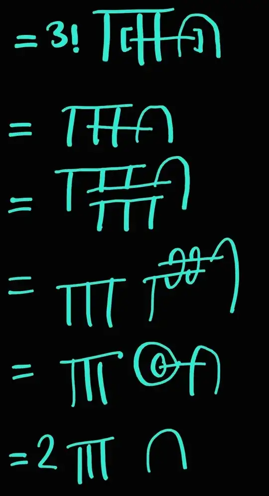

Using the properties of the generalized Kronecker delta \begin{align} 3!\epsilon_{i[jk}\delta_{l]m} &= \delta^{pqr}_{jkl}\epsilon_{ipq}\delta_{rm} \\ &= \epsilon_{jkl}\epsilon^{pqr}\epsilon_{ipq}\delta_{rm} \\ &= \epsilon_{jkl}\delta^{pqr}_{ipq}\delta_{rm} \\ &= \epsilon_{jkl}\delta^{rpq}_{ipq}\delta_{rm} \\ &= 2\epsilon_{jkl}\delta^{r}_{i}\delta_{rm} \\ &= 2\epsilon_{jkl}\delta_{im} \\ \end{align} where the $[\dots]$ denote antisymmetrization. Now the left hand side is $$3!\epsilon_{i[jk}\delta_{l]m} = 2(\epsilon_{ijk}\delta_{lm} +\epsilon_{ikl}\delta_{jm} +\epsilon_{ilj}\delta_{km}) $$ so dividing by $2$ you get $$\epsilon_{ijk}\delta_{lm} +\epsilon_{ikl}\delta_{jm} +\epsilon_{ilj}\delta_{km} =\epsilon_{jkl}\delta_{im}. $$
I want to remark that I translated the first calculation in my post from Penrose graphical notation. Here is my original calculation. I hope it convinces you to at least take a look at the wiki article :D it's very nice for tensor calculations.
