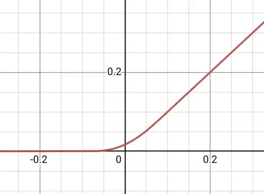

I don't fully got your question, but I believe you are looking something like this function: $$h(x)=\begin{cases} 0,\quad x\leq -\frac18 \\ x,\quad x\geq \frac18\\ \int\limits_{-\frac18}^x \frac{1}{1+\exp\left(\frac{32u}{64u^2-1}\right)}\ du,\ \text{otherwise} \end{cases}$$
which makes a smooth transition from $f(x)=0$ into $f(x)=x$.
I built it following the method shown in Wikipedia for smooth Bump functions.
You could see the function on Desmos: Desmos example

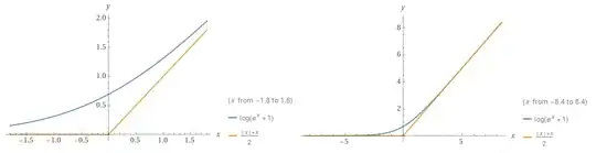

Asking a different question I found that there is a simple smooth version of the ramp function named in Wikipedia as Softplus function:
$$f(x) = \ln(1+e^x)$$
Achieves what you are aiming to do (you just need to displace and scale it - as example $f(8x-4)$), and it is smooth since its derivative is the Logistic function.
plot

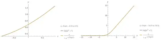

Also, this function could be approximated by: $$\ln(1+e^x) \approx \begin{cases} \frac{x}{1-e^{-\frac{x}{\ln(2)}}},\quad x\neq 0\\ \ln(2),\quad x=0\end{cases}$$
as could be seen in their plot:
comparison of the plots
You could find other approximations in this Wikipedia page: Rectifier functions.
