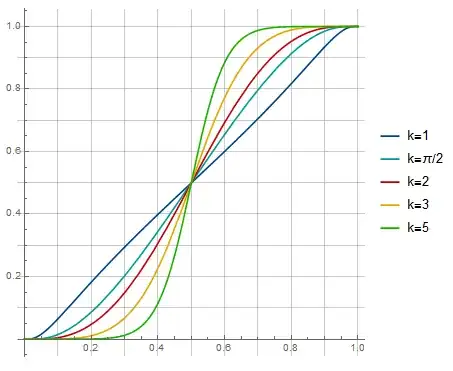

My version of step-smooth function with infinite count of zero derivatives is
\begin{align} f(x) = \begin{cases} 0& x\leq 0\\ \frac{1}{2} \left(\tanh \left(\frac{k (2 x-1)}{2 \sqrt{(1-x) x}}\right)+1\right)& 0<x<1 \\1 & x\geq 1\end{cases} \end{align}
where $k$ is derivative at $x=1/2$.

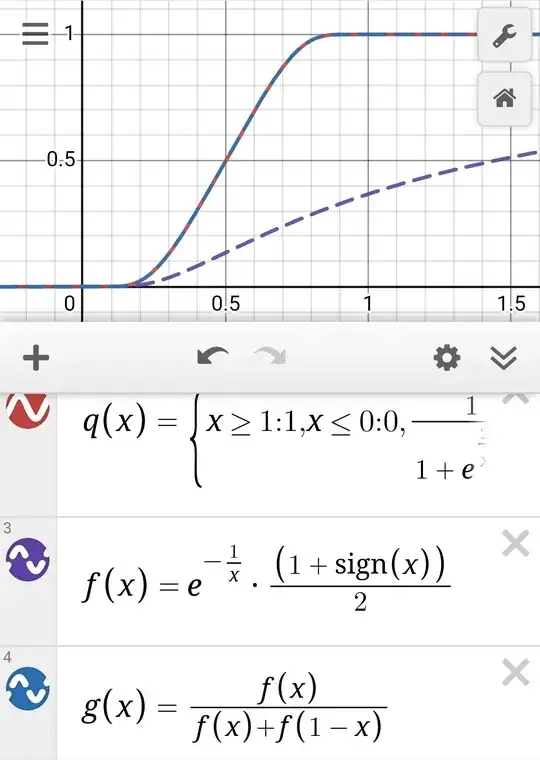

Following the answer by @user98602, you could use as example a piecewise version of the function $\frac{1}{1+\exp((2x-1)/(x^2-x))}$, which details could be found in this question I did: $$r(x)=\dfrac{1}{1+\exp\left(\dfrac{2x-1}{x^2-x}\right)\dfrac{\left(1+\text{sgn}(1-x)\right)}{\left(1+\text{sgn}(x)\right)}}$$
will make the trick, in principle. But caution must be taken since as could be seen the function $r(x)$ is undefined at the points $x=\{0,\ 1\}$ (something similar happened in this question), so to keep smoothness a piecewise definition is mandatory: $$q(x)=\begin{cases}0,\quad x\leq 0\\ 1,\quad x\geq 1\\ \dfrac{1}{1+\exp\left(\dfrac{2x-1}{x^2-x}\right)},\ \text{otherwise} \end{cases}$$
Also be aware that since this function behave as flat function so by its nature is an example of non-analytic smooth functions, as also are smooth bump functions (this is why I edit one of your original tags).
You could see these functions in Desmos:
Desmos examples
