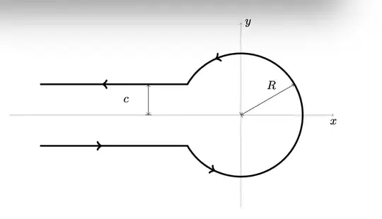

The Hankel path $H(c,R)$ is an infinite path that starts at a point at infinity $-\infty - ic$ to a point on a circle of $C_R$ radius $R$ ($0<c<R$) centered at the origin along the line $y=-c$, continuing along the an arc on $C_R$ to a point on the line $y=c$, and then to the point at infinity $\infty+ic$ along the line $y=c$.

Assume that $z>0$ and choose the principal branch of $\operatorname{Log}$ which is defined on $P:=\mathbb{C}\setminus\{x+iy: y=0,x\leq 0\}$. Observe that the path of any Hankel loop $H(c',R')$ is contained in the principal domain $P$.
Define the function $$ G(w)=\sum^\infty_{n=0}\frac{(-1)^n}{n!}\frac{z^n w^{-n}}{2^n}w^{-\nu-1}e^{\frac{1}{2}zw} $$
Suppose $\nu=a+ib$. Then for any $w\in P$, $$|w^{-\nu-1}e^{\frac12zw}|=e^{\frac12z\mathfrak{R}(u)}e^{(-a-1)\log|w|+b\operatorname{arg}(w)}\leq e^{\frac12z\mathfrak{R}(u)}|w|^{-a-1}e^{|b|\pi} $$ Hence, $$|G(w)|\leq e^{|b|\pi}e^{\frac12z|w|^{-1}}|w|^{-a-1}e^{\frac12z\mathfrak{R}(w)}$$
integration over $H(c',R')$ yields \begin{align} \int_{H(c',R')}|G(w)||dw|&\leq 2e^{|b|\pi}\int^\infty_{a(c',R')}e^{\frac12z|t^2+(c')^2|^{-1/2}}|t^2+(c')^2|^{-\frac{a+1}{2}}e^{-\frac12zt}\,dt\\ &\qquad\qquad +\quad e^{|b|\pi}(R')^{-a}e^{\frac12zR^{-1}}\int^{\theta(c',R')}_{-\theta(c',R')}e^{\frac12zR'\cos s}\,ds<\infty \end{align} where $a(c',R')=\sqrt{(R')^2-(c')^2}>0$ and $\theta(c',R')=\operatorname{arg}(-a(c',R')+ic')$.
The conclusion then follows by dominates convergence.
