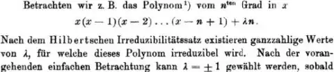

I can't read German, but the very specific example $\,x(x-1)\ldots(x-n+1) + \lambda n\,$ appears to be mentioned in Pólya's paper as a concrete solution $\lambda=\pm 1$ to Hilbert's existential irreducibility theorem in this case.

    A great find! Polya's proof is on the previous page of that article. Do you mind, if I add an English translation of the argument to your answer for the purposes of helping the viewers? Most likely you can reproduce it yourself, but it would be no trouble at all. – Jyrki Lahtonen May 01 '23 at 06:06
