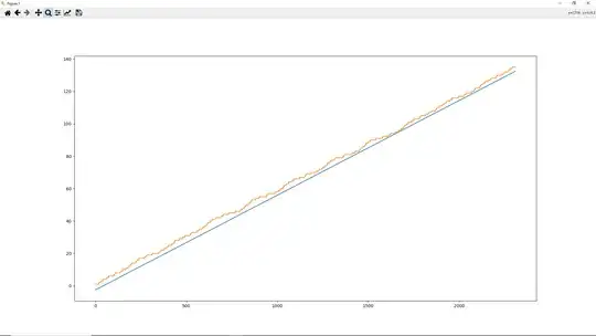

Graph of y-offset b = -n/2 line next to the twin prime counter on that interval
This code which generates the above screenshot showing the trend line above next to what it lower bounds, but zoomed in on the window of $X = p_{n} + 2... 2\cdot( p_{n+1}^2 - 2)$.

It's already been proven that the slope is indeed correct, here by Bryan Moehring, even for more general sums of such step functions. In other words, any such trend line or bounding line must have a slope of that form, so that is solved for. I merely seek a constant for $b$. I think $b = -n/2$ seems like good choice. Judging by zooming in on the above $n=5$ screenshot, it's a really tight bound.
