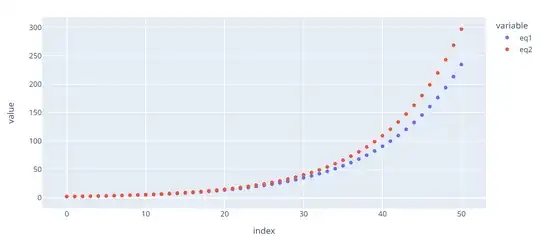

Now I tried to plug some numbers in to simulate the results and I found out that they are in fact different... but shouldn't they be the representation of the same phenomenon?
Here is the plot for the 2 equations enter image description here
Maybe the error is thinking that r must be the same? But if so what is the relationship between the discrete and continuous $r$?

In the continuous model the rate assumes instantaneous compounding. If $1+r$ is the rate (as a factor) for the discrete model and you use that rate for continuous compounding then the equation is, as you say $$ n = n_0e^{\rho t} . $$ For small values of $r$, $e^r \approx 1+r$ .
In this model, births and deaths occur at any time, not just at discrete intervals. Think about what happens when you open an account earning $6\%$ annual interest. If the bank adds the interest to your account every millisecond then at the end of a year your initial investment will be $e^{0.06} = 1.061836\ldots$ as large, not just $1.06$.
So there is no contradiction in the two curves. The continuous one should be higher, and it is.
If you want to match the curves you have to reverse engineer the rate $s$ for the continuous model. That means you want $$ e^s = 1+r $$ so $s = \ln(1+r)$.
That gives $s=0.058\ldots$ for $r = 0.06$.

  • Well i understand now but your math is wrong: if the discrete eq looks like this $N(t) = n_0 \cdot r^t$ then the continuous is obtained simply by considering that $r^t = e^{\ln{r}^t} = e^{t \ln{r}}$. So the continuous form is actually $n(t) = n_0 e^{t \ln{r}}$ – Mirko Mar 31 '23 at 23:14
  • @Mirko I am embarrassed at how many iterations it's taken me to get this right. Thanks for your patience. – Ethan Bolker Apr 01 '23 at 00:41
