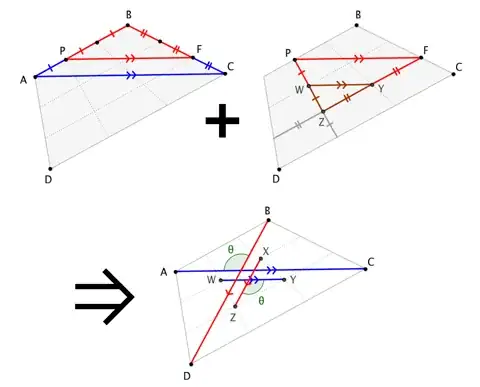

Claim. $W$ and $Z$ trisect $\overline{PH}$. Likewise elsewhere.
Proof. Left to the reader (for now).
Given the claim, we can make this illustrated argument:
Here, we have $\triangle ABC \sim \triangle PBF$, with $$\frac{|\overline{PB}|}{|\overline{AB}|} = \frac{|\overline{FB}|}{|\overline{CB}|} = \frac{2}{3} = \frac{|\overline{PF}|}{|\overline{AC}|} \qquad \text{and} \qquad \overline{PF} \parallel \overline{AC}$$ and $\triangle PZF \sim \triangle WZY$, with $$\frac{|\overline{WZ}|}{|\overline{PZ}|} = \frac{|\overline{YZ}|}{|\overline{FZ}|} = \frac{1}{2} = \frac{|\overline{WY}|}{|\overline{PF}|} \qquad \text{and} \qquad \overline{WY} \parallel \overline{PF}$$ so that $$|\overline{WY}|= \frac13 |\overline{AC}| \qquad \text{and} \qquad \overline{WY} \parallel \overline{AC}$$ and likewise $$|\overline{XY}|= \frac13 |\overline{BD}| \qquad \text{and} \qquad \overline{XZ} \parallel \overline{BD}$$
By the Diagonal-Diagonal-Angle formula for quadrilateral area, $$|\square WXYZ| = \frac{1}{2}|\overline{WY}||\overline{XZ}|\sin\theta = \frac12 \cdot \frac{1}{3}|\overline{AC}| \cdot \frac13 |\overline{BD}|\cdot \sin\theta = \frac19 |\square ABCD|$$
