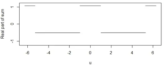

To illustrate this, here is the real part of the sum plotted against $u$ with $u \in [-2\pi,2\pi]$
Real

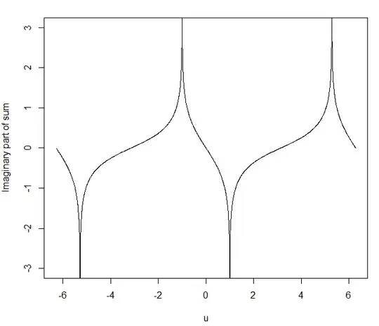

and then the imaginary part of the sum plotted against $u$
Imaginary

In particular, $2\Re S_u=\arg (1-e^{i(-u-1)})-\arg (1-e^{i(-u+1)})$ and we have three cases: $0 \le u < 1, 1 < u < 2\pi -1, 2\pi -1 < u <2\pi$ and in the first case we get $2\Re S_u=\pi+\frac{(-u-1-\pi)}{2}-\frac{(-u+1-\pi)}{2}=\pi-1$, in the second we get $-1$ as there is no extra $\pi$ from a jump, and in the third again $\pi-1$ since now we subtract $\pi$ from the second negative term, while clearly at the border we get the average as one term is continuous and the other gives the average by Fourier series classical results.
So putting it together for $u \in [0, 2\pi)$ we get $$\Re S_u=-\frac{1}{2}, 1< u < 2\pi -1$$ and $$\Re S_u=\frac{\pi-1}{2}, 0 \le u<1, 2\pi-1<u<1$$, with $$\Re S_u=\frac{\pi-2}{4}, u=1,2\pi-1$$ and of course the result extends by periodicity to any $u$ and can be written as in the OP.
As for the imaginary parts, that is $\frac{1}{2}\log |\frac{\sin \frac{1-u}{2}}{\sin \frac{1+u}{2}}|$ since when $-u \pm 1$ get out of the $[0, 2\pi)$ range the $\sin$ changes to its negative so we always have the $\log |\sin t/2|$ term for any real $t$ and $$2\Im S_u = \Re\log(1-e^{i(-u+1)})-\Re \log(1-e^{i(-u-1)})$$ as the sign changes because of the $i$ and by continuity this takes all values since it takes $\infty$ as $u \to 2\pi-1$ and takes $-\infty$ as $u \to 1$
