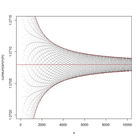

$\sum\limits_{k=1}^n \frac{\sin(k)}{k}$ converges as $n$ increases, to a limit of $\frac12(\pi-1) \approx 1.0708$
Empirically, it seems to be bounded by about $\frac12(\pi-1) \pm \frac{1.043}{n}$, as shown in the chart below.
What is the precise value of this $1.043$ term?
Added: I think the three answers from Oliver Diaz, Gary, and Gabriel Romon, plus the comments, have demonstrated that the bounds are $$\frac12(\pi-1) \pm \frac1{2\sin(1/2)}\frac{1}{n}$$ not only asymptotically but also as tight actual bounds; $\frac1{2\sin(1/2)}\approx 1.0429148214667441$
\sum\limits_{k=1}^n \frac{\sin(n)}{n}
created in R with
n <- 1:11000
plot(n, cumsum(sin(n)/n), ylim=c(1.07,1.0715), xlim=c(1,10000), pch=46)
abline(h=(pi-1)/2, col="red")
curve((pi-1)/2 + 1.043/x, from=1, to=max(n), add=TRUE, col="red")
curve((pi-1)/2 - 1.043/x, from=1, to=max(n), add=TRUE, col="red")

    From the post you linked, you're either trying to find
    $$\sup_{n\geq 1} n\left|\int_{0}^{1}\left(\frac{1}{2\sin{\frac{t}{2}}}-\frac{1}{t}\right)\sin \frac{(2n+1)t}{2}\ dt +\int_{(2n+1)/2}^{\infty}\frac{\sin t}{t}dt\right|$$ or, if it's only the asymptotics you care about, $$\limsup_{n\to\infty} n\left|\int_{0}^{1}\left(\frac{1}{2\sin{\frac{t}{2}}}-\frac{1}{t}\right)\sin \frac{(2n+1)t}{2}\ dt +\int_{(2n+1)/2}^{\infty}\frac{\sin t}{t}dt\right|$$
    I have no clue how to simplify these to more elementary values (if it's possible). This is the reason I'm making this a comment, not an answer.
    – Brian Moehring Apr 14 '21 at 17:22
  • @BrianMoehring Indeed - I do not have a clue either. Empirical calculations suggest that the two may be the same: for example, looking at the first million terms, those with $n=990063$ and $n=990418$ seem to provide new records above and below of about $\pm1.042914$ but further records come just over a million – Henry Apr 14 '21 at 18:10
  • @OliverDiaz Are you saying $\dfrac1{2\sin(\frac12)} \approx 1.0429148$ is the answer? It looks possible – Henry Apr 14 '21 at 18:36
  • @Henry: I added to my answer specific calculations for sine series. They turn out to be easy to obtain. In any event, I obtain the same theoretical bound, i.e. twice your bound. Maybe finer methods are require to get reach your bound. Or maybe I am making a silly mistake and I am missing a $1/2$ factor. – Mittens Apr 14 '21 at 23:28
  • @OliverDiaz - you efforts are beyond my knowledge, but I am increasingly convinced that you have found the correct answer (apart from the factor of $1/2$). On the factor of $1/2$ my only thought is that with $\sum\limits_{k=-n}^n e^{ikx}=\frac{\sin\left(\left(n +1/2\right) x \right)}{\sin(x/2)}$, you subtract $1$ and then divide by $2$ to get the real part of $\sum\limits_{k=1}^n e^{ikx}$ – Henry Apr 14 '21 at 23:41
  • @Henry See my (perfectible) answer below – Gabriel Romon Apr 15 '21 at 10:30

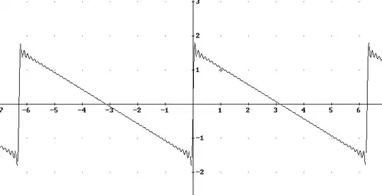

Comment: The value of this sum is indeed (pi-1)/2. This is confirmed by noting that the function f(x) = pi-x on (0, pi), extended oddly to (-pi, 0), and then extended to all real numbers periodically and with the usual convention, has Fourier series = sum(sin(nx)/n; n=1,2,...). The extended function is continuous except at integer multiples of pi. Hence, we have equality at x=1, so the sum in question = f(1) = (pi-1)/2.
For more details, see: Michael W. Ecker, Combining Mathematics and Technology to Sum Certain Series, Mathematics and Computer Education, Winter 2013, Vol. 47, No. 1, p. 19-23.
Graph of f and a partial sum of Fourier series
    That is a well known fact, as you know. The problem is about how fast the series converges for a pint within the domain of continuity. $x=1$ is just once example. The OP could have chosen $x=2$ and something similar (with a different constant in the bound $O(1/n)$ ) would have occur. – Mittens Apr 20 '21 at 18:45
