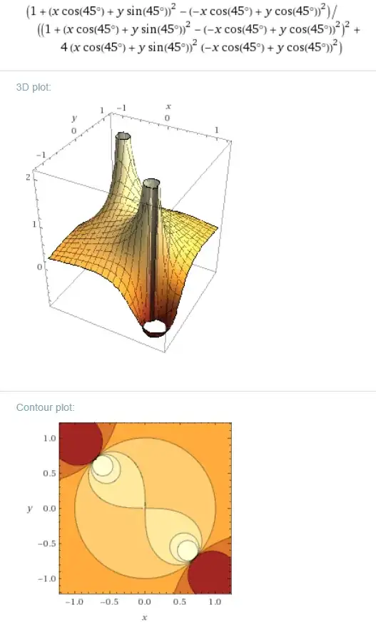

If y=1, then: $$(1 + x^2 - 1^2)/((1 + x^2 - 1^2)^2 + 4 x^2×1^2)=x^2/(x^4 + 4 x^2)$$ Maybe try rotating the surface instead of slicing at an angle. How to rotate the graph $z=f(x)$ towards $y$ so that $z=f(x,y)$?
x' = x cos(theta) +y sin(theta) , y'=-x sin(theta)+y cos(theta)
z=x^3 becomes: z=(x\cos45^\circ+y\sin45^\circ)^3
$$Re(\frac{1}{(1+z^2)})=\frac{1+(x\cos45^\circ+y\sin45^\circ)^2-( -x sin(45)+y cos(45) )^2}{(1+(x\cos45^\circ+y\sin45^\circ)^2-(-x sin(45)+y cos(45))^2)^2+4(x\cos45^\circ+y\sin45^\circ)^2(-x sin(45)+y cos(45))^2}$$
\frac{1+ (xcos45+ysin45) ^2-( -x sin(45)+y cos(45) )^2}{(1+(xcos45+ysin45)^2- (-x sin(45)+y cos(45))^2)^2+4 (xcos45+ysin45) ^2(-x sin(45)+y cos(45))^2}
Wolfarm Alpha reduced this too: $$\frac{(2 x y + 1)}{(x^4 + 2 x^2 y^2 + 4 x y + y^4 + 1)}$$

This answer agrees 100% with BernardK's answer and Is likely a superior way of slicing that I did above.

THeta=90 This was supposed to rotate the surface not slice it along the y axis.
Note that the z=2 curve is the lemniscate of Bernoulli. How to match my curve with the correct lemniscate?
