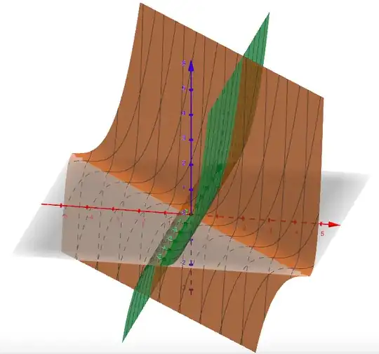

Here is a graph (created at https://www.geogebra.org/3d) of $z=x^3$ (in green) and $z=(x\cos45^\circ+y\sin45^\circ)^3$ (in brown):
Rotation of $z=x^3$
