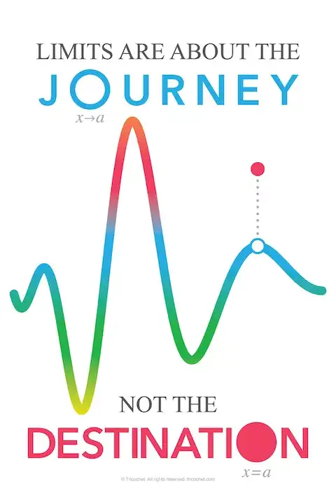

This (new version of an old) image of mine seems apropos:
In the case of $\lim_{x\to 5} \frac{x^2-25}{x-5}$, the message here is: Away from $x=5$, the function $\frac{x^2-25}{x-5}$ is completely identical to $x+5$; thus, what we expect to find as we approach $x=5$ is the value $5+5$. This anticipated value is what a limit computes.
The fact that the original function isn't defined at $x=5$ is immaterial. Walley World may be closed for repairs when you arrive, but that doesn't mean you and your dysfunctional family didn't spend an entire cross-country road trip anticipating all the fun you'd have there.

    Extremely helpful answer as always, Blue. You're incredible at understanding what people are really asking and providing strong intuition. Thank you for your contribution to this site! – jeremy radcliff Jun 01 '15 at 15:55
    @Blue Your answer made me think something: Can we always find another function which - away from a certain value - is completely identical to the former function? I mean, what is done in this example is the following: We have an algebraic expression and we can find another algebraic expression that have that property. – Red Banana Jul 06 '17 at 01:21
  • BTW: I read your image as the jingles in this video. – Red Banana Jul 06 '17 at 01:21
    Super answer...the craziest I ever read in here – MattAllegro Jul 13 '19 at 22:17
  • @Blue: Shameless plug: A downloadable poster version of the "Journey/Destination" image is available at my Etsy shop, and a t-shirt is available from Spring. (I'll delete this comment if there are objections.) – Blue Oct 12 '21 at 10:00
