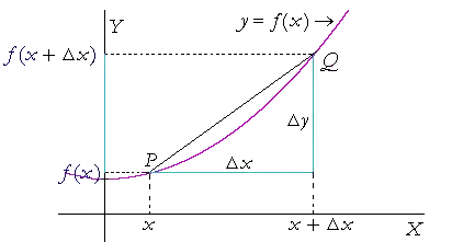

Consider the graph below which is an identical graphical representation of Equation $(1)$:
limit graph
You can see from the graph that the Secant line, which is the line that intersects the purple curve at $(x,f(x))$ and at $(x+\Delta x,f(x+\Delta x))$ is an approximation to the derivative (tangent) of the purple curve at $(x,f(x))$.
Now imagine $\Delta x$ getting smaller and smaller until eventually it becomes vanishingly small; which we call 'infinitesimal' (loosely speaking this is as small as you can possibly get but still greater than zero).
At this point you can see that the Secant line approaches the Tangent line or derivative at $(x,f(x))$ as $\Delta x$ tends to zero. Thus, the approximation of the Secant line to the Tangent line is optimal at $(x,f(x)+\Delta x)$ and this is the exact meaning of Equation $(1)$.
