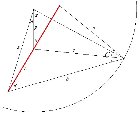

Let the radius of the circle be $1$, and let the length of the line segment be $2L$, where $L<1$.
In deciding where to draw the line segment, the variables are:
$p=$ distance between centre of circle and midpoint of line segment
$\theta=$ acute angle between line segment, and line through centre of circle and midpoint of line segment.
The diagram shows the line segment in red, and one of the randomly chosen points on the circle.
For each value of angle $x$, the probability that the line segment is intersected by the random chord, is $C/\pi$.
The overall probability is the average value of $C/\pi$, as angle $x$ goes from $0$ to $2\pi$.
It takes a bit of work to express $C$ in terms of $L, p, \theta, x$:
$a=\sqrt{p^2+L^2-2pL\cos{(\pi-\theta)}}$ (cosine rule)
$A=\arcsin{\left(\frac{L\sin{(\pi-\theta)}}{a}\right)}$ (sine rule)
$b=\sqrt{1^2+a^2-2a\cos{(A+x)}}$ (cosine rule)
$c=\sqrt{1^2+p^2-2p\cos{x}}$ (cosine rule)
$\cos{B}=\frac{b^2+L^2-c^2}{2bL}=\frac{b^2+(2L)^2-d^2}{4bL}$ (cosine rule) $\implies d=\sqrt{2L^2-b^2+2c^2}$
$C=\arccos{\left(\frac{b^2+d^2-(2L)^2}{2bd}\right)}$ (cosine rule)
$P=P(\text{line segment is intersected by chord})=\frac{1}{2\pi}\int_0^{2\pi}\frac{C}{\pi}dx$
Putting all of this into my computer, it seems that, for any value of $L<1$, $P$ is maximized when the line segment is drawn as a chord of the circle. But trying to prove this analytically seems daunting.

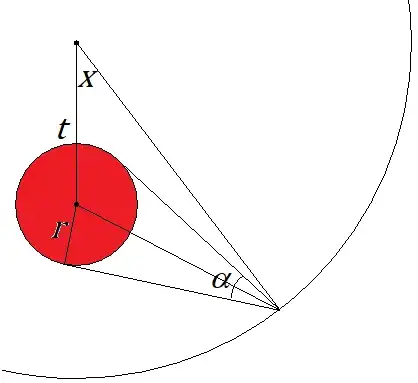

Consider a disk of radius $r<1$ placed inside a unit circle. The distance between their centres is $t$, and $P(t)$ is the probability that a random chord (chosen by connecting two uniformly random points on the unit circle) will intersect the disk.
We will try to show that $P(t)$ is an increasing function in $t$. Then in the original question, regard the line segment as a rigid row of many small disks. When the line segment (i.e. row of disks) is a chord of the unit circle, the $t$-value of each small disk is maximized, so the probability that the line segment is intersected by a random chord is maximized.
The diagram shows a disk, and one of the randomly chosen points on the circle.
For each value of angle $x$, the probability that the disk is intersected by the random chord, is $\alpha/\pi$.
The overall probability is the average value of $\alpha/\pi$ as angle $x$ goes from $0$ to $2\pi$.
$\alpha=2\arcsin{\left(\dfrac{r}{\sqrt{1+t^2-2t\cos{x}}}\right)}$
$P(t)=\dfrac{1}{\pi^2}\int_0^{2\pi}\arcsin{\left(\dfrac{r}{\sqrt{1+t^2-2t\cos{x}}}\right)}dx=\dfrac{2}{\pi^2}\int_0^{\pi}\arcsin{\left(\dfrac{r}{\sqrt{1+t^2-2t\cos{x}}}\right)}dx$
We can express the integral as a riemann sum, then differentiate with respect to $t$, then express the new riemann sum as an integral. So we get:
$\dfrac{dP(t)}{dt}=\dfrac{2r}{\pi^2}\int_{0}^{\pi}\dfrac{\cos{x}-t}{(1+t^2-2t\cos{x})\sqrt{1+t^2-2t\cos{x}-r^2}}dx$
Since $r$ will approach $0$, I think we can ignore the $r^2$ in the denominator.
So we just have to show that $\int_{0}^{\pi}\dfrac{\cos{x}-t}{(1+t^2-2t\cos{x})^{1.5}}dx>0$ for $0<t<1$, but I do not know how to show this. I found a related question, but it has not helped me.

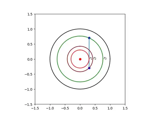

Hint Let us say that a chord is of type $d\in [0,1]$ if its distance to the origin of the circle is $d$. First determine the density of chords of type $d$ in the set of all the random chords. This should not be too difficult.
Then consider the following figureenter image description here
Consider 4 cases, $d\in [0, r_1]$ or $[r_1, r_2]$ or $[r_2, r_3]$ or $[r_3, 1]$ and in each case determine the proportion of chords of type $d$ intersecting the segment. For this one only needs to draw lines passing throw the ends of the segment that are tangent to the circle of radius $d$, these lines determine one or two portions of the unit circle corresponding to chords that intersect the segment. Thus one can obtain the probability that a chord of type $d$ intersects the segment. For example if $d\ge r_3$, the probability is $0$.
It remains to integrate these results over $d$ to get the probability that a chord intersects the segment.

From the OP's "Attempt $2$":
$P(t)=\dfrac{2}{\pi^2}\int_0^{\pi}\arcsin{\left(\dfrac{r}{\sqrt{1+t^2-2t\cos{x}}}\right)}dx$
$\overset{r\to0}{\to}\dfrac{2}{\pi^2}\int_0^{\pi}\dfrac{r}{\sqrt{1+t^2-2t\cos{x}}}dx$
$\overset{x=2u}{=}\dfrac{4r}{\pi^2}\int_0^{\pi/2}\dfrac{1}{\sqrt{(1+t)^2-4t\sin^2{u}}}du$
which for $0<t<1$ is equivalent to $\dfrac{4r}{\pi^2}\int_0^{\pi/2}\dfrac{1}{\sqrt{1-t^2\sin^2{u}}}du$, which is increasing in $t$.
As the OP's "Attempt $2$" explains, this implies that the line segment should be drawn as a chord, to maximize the probability that the line segment will be intersected by the random chord.

  • I don't think it is correct to say that the probability that the disk is intersected by the random chord is $\alpha/\pi$ in the Attempt 2. It means that you may start with the wrong formula. – Gribouillis Dec 17 '22 at 15:13
    @Gribouillis I still think $\alpha/\pi$ is correct. In Attempt 2, the diagram shows the first random point on the circle, and lines through this point and tangent to the disk. We can extend these lines so that they intersect the circle on the other side of the disk. If the second random point on the circle is between those two intersections, then the chord will intersect the disk. The arc length between those two intersections is $2\alpha$, and the circumference of the circle is $2\pi$, so the probability that the chord will intersect the disk is $\alpha/\pi$. – Dan Dec 18 '22 at 00:39
  • All right, I agree that the probability is $\alpha/\pi$ now. I'm working on understanding the rest of the argument... – Gribouillis Dec 18 '22 at 09:00
