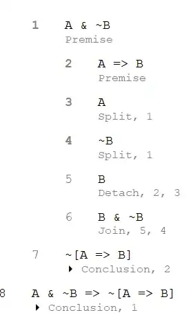

Similarly, (2) can be derived as follows:
The derivations of (3) and (4) are left as an exercise.
