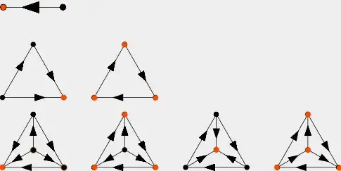

For example
these are all tournaments and the $\color{red}{\text{red}}$ dots are the losers. Notice how there is always a cycle joining them.
