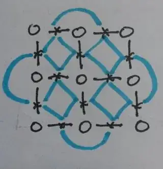

The problem is equivalent to the traveling salesman problem. We can visualize this with a 3x3 version:
Here the intersections are circles and are connected by a line. Draw something like the dual of the graph, i.e. on each edge place a new vertex (marked by an X) and connect those vertices if you could get from one street to another (blue line). Your problem really isn't about the intersections (circles), but about streets themselves (x's).
Each blue line has a weight, the cost of going from one street to another. On a uniform city block all the weights are unity. We now have the traveling salesman problem since we want to find the shortest route that visits every (X) vertex at least once.
In general this problem is NP-complete, meaning it is (probably) quite difficult to solve exactly. However, our graph has symmetry and structure that may be worth exploiting. There are also approximate algorithms that do good job much more quickly. In addition, the computational cost might be worth if Grandma gets lost in the same city all since the underlying graph (and hence the solution) would be the same.
