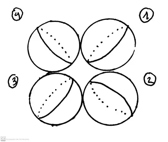

Let us start with $p_H$. Consider $X_H$ a string $2n$ spheres $S^2$ wedged together so that each sphere are wedge to other spheres at both the north and south poles. The following figure shows the case $n=2$: enter image description here
Let $G$ be the presentation group $\langle a,b\,|\, a^2,b^2, (ab)^n\rangle$. It is easy to see that $G$ has only four elements: the identity $e$, $a$, $b$ and $ab$. Then we can define an action $p:G\to \textrm{Hom}(X_H)$ of $G$ over $X_H$ by a natural manner so that the orbit space $X_H/G$ is homeomorphic to $\mathbb R\mathbb P^2\vee \mathbb R\mathbb P^2$. By the Propositiion 1.40 of Hatcher's book, we can conclude that $G$ must be isomorphic to: $$\frac{\pi_1(\mathbb R\mathbb P^2\vee \mathbb R\mathbb P^2)}{(p_H)_\star(\pi_1(X_H))}$$ This implies that $(p_H)_\star(\pi_1(X_H))$ is isomorphic to $H$.
