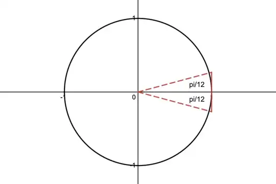

Here's an idea that, like insipidintegrator's answer, avoids an approximation. Use a circumscribing polygon to upper-bound the circumference of the circle. I use a dodecagon, whose perimeter is
$$ P = 24 \tan \frac{\pi}{12} = 24(2-\sqrt3) $$
We want to show that this $P < 2\left(\frac{23}{7}\right) = \frac{46}{7}$.
\begin{align} 24(2-\sqrt3) < \frac{46}{7} & \Leftrightarrow 84(2-\sqrt{3}) < 23 \\ & \Leftrightarrow 168-84\sqrt{3} < 23 \\ & \Leftrightarrow 145 < 84\sqrt{3} \\ & \Leftrightarrow 21025 < 21168 \end{align}
Then, since $2\pi < P$, we have $\pi < \frac{23}{7}$. It should be pointed out that this does require you to accept that a circumscribing polygon is longer in perimeter than the circumference of the circle.
