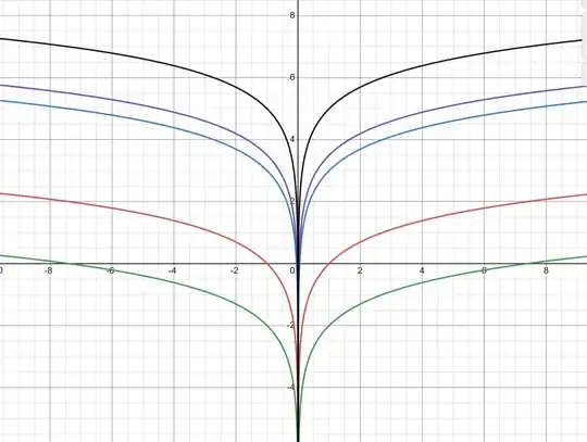

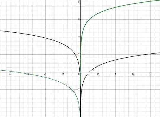

However remember that computing definite integrals is not the only point of integration. The indefinite integral asks "what functions have ... as their derivative". And then formula (1) is just not the full answer. It makes you believe that all antiderivatives of $y=1/x$ look like these:
But in reality, there are many more, and they are only visible in formula (2). Here are two of them:
So if "additional value" means that you understand how many different antiderivatives a function can have, here it is. Note this will be far more striking if you ever want to solve differential equations.
