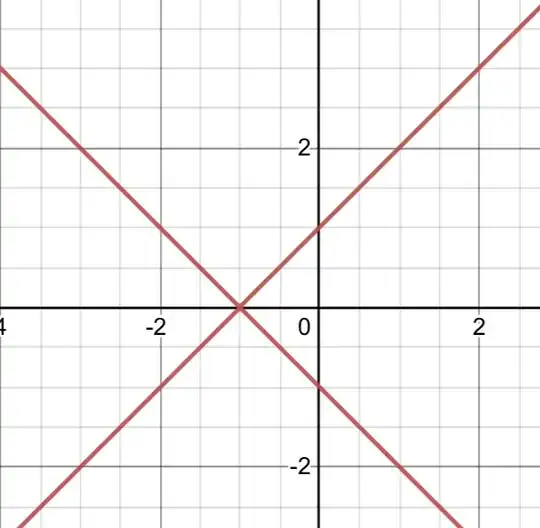

The answer you got at (1): $$|y|=|x+1|e^C$$ does not represent a function but a relation.
The graph appears as two lines intersecting at x=-1.
Look how the plot looks for C=0: enter image description here

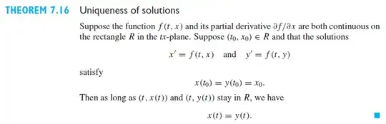

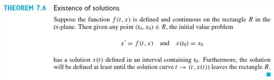

Now, let's go back to the textbook to see the Theorem of Existence and Uniqueness (TEU) for the first order DE.
Note those symbols in the textbook are $(t, x)$, rather than $(x, y)$, if we convert your DE by using the symbols in the textbook, we get:
$$x'=f(t, x)=\frac{1}{1+t}x$$
From the TEU, we can see $t=-1$ is a discontinuous point (singularity) for this DE.

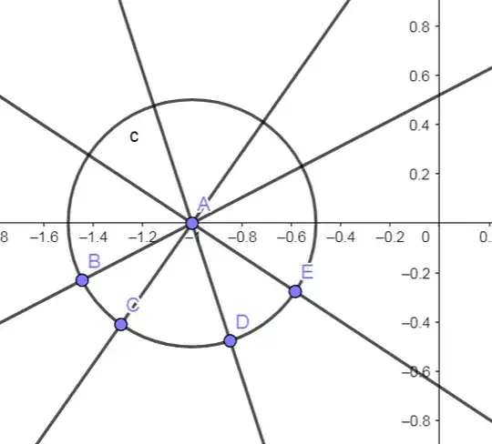

Below is a complete characterization of $C^1$-solutions in $\mathbb{R}^2\setminus\{(-1,0)\}$:
We substitute $x = -1 + r \cos\theta$ and $y = r \sin\theta$, where $r > 0$ and $\theta \in \mathbb{R}/2\pi\mathbb{Z}$. Then
\begin{align*} 0 &=(x+1) \, \mathrm{d}y - y \, \mathrm{d}x = r^2 \, \mathrm{d}\theta \end{align*}
Since $r > 0$, this implies that $\mathrm{d}\theta = 0$, hence any solution must lie in the half-infinite ray $R_{\alpha}$ of the form
$$ R_{\alpha} = \{(x, y) : \theta=\alpha\} = \{(-1 + r \cos\alpha, r\sin\alpha) : r > 0\}. $$
Remarks.
  • For any $C^1$ function $r(t) > 0$ and for any fixed $\alpha \in \mathbb{R}$, the parametric equation
    $$ \begin{cases} x(t) = -1 + r(t)\cos\alpha, \\ y(t) = r(t)\sin\alpha \end{cases} $$
    traces part of the ray $R_{\alpha}$ and hence defines a solution of OP's equation.
  • When $\cos\alpha \neq 0$, the ray $R_{\alpha}$ is part of the line
    $$ y = (x + 1)\tan\alpha, $$
    showing that this solution coincides with the answers of other users.
Sangchul Lee

You start with the equation
$$ (1+x)\text dy - y\text dx = 0 $$
Both sides of this equation defined (indeed, analytic) on the entirety of $\Bbb R^2$. You then transform it into the equation
$$ y^{-1}\text dy = (1+x)^{-1}\text dx $$
The left hand side is no longer defined at $y = 0$, while the right hand side is no longer defined at $x = -1$. Clearly, this equation is not equivalent to the one you started with, so taking the results of solving this new equation at face value will lead you to incorrect conclusions.
Let's see how we can work around this. One thing we note is that we're looking for a relationship $y = f(x)$ -- and thus $\text dy = f'(x)\text dx$ -- that makes the equation true. If the equation is true, then the singularities on each side of the equality must be consistent with one another, and so we expect to have a hole in the solution graph at $(-1,0)$. How we "repair" that hole depends largely on the assumptions that we make about $f$.
If $f$ is only required to be differentiable away from $-1$, then the punctured domain gives us a lot of freedom. Indeed, we are really solving the equation twice: once for $x < -1$ and once for $x > -1$. The solution to each of these is the set of lines whose respective one-sided limit as $x\to -1$ is $y\to 0$. Then, the value of $f(-1)$, if we choose to assert its existence, can be any real value. This gives us 3 free choices: the slope of the left line, the slope of the right line, and the height of the middle point.
If we also want $f$ to be continuous at $-1$, then we immediately see that $f(-1)$ is fixed. By the definition of continuity, we have that both one-sided limits being $0$ necessarily implies that the value of the function exists and is also equal to $0$. Thus, $f(-1) = 0$, while the two slopes are still free and independent.
Finally, if we require $f$ to be differentiable on the whole domain, then the two one-sided limits of slopes need to agree there as well. Since the curves on either side of $-1$ are lines, slope is equal everywhere and thus the limit is also the slope. This means that, in order for the limits to be equal, the slopes must be equal, and together with the continuity assumption fixing the middle point, the resulting curve is a line which passes through $(-1,0)$. It may still have any slope, we are down to just one free choice.
The base assumption, unless otherwise stated, is that a (classical) solution to a differential equation is differentiable on the domain of definition. Because the original equation was defined everywhere, its solution must be differentiable everywhere, and so the last paragraph is the situation we are required to take. This gives a general solution
$$ y = c(1+x) $$
while the various absolute value solutions are only valid for the case where $f$ is just required to be continuous at $-1$, but differentiable everywhere else.
