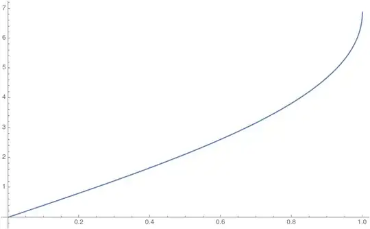

The above, as per the OP's question, corresponds to the initial condition $a_1=1$. Using the same argument, one easily gets that, for $a_1=\alpha\in[0,1]$, the limiting constant for $4^n a_n$ is given by $$ C(\alpha) = 4\operatorname{arcsl}(\sqrt{\alpha})^2 = 4\left(\int_0^{\sqrt{\alpha}} \frac{dx}{\sqrt{1-x^4}}\right)^2 \tag{6} $$ where $\operatorname{arcsl}$ is the lemniscate arcsine function. The behavior of $C(\alpha)$ as $\alpha$ ranges from $0$ to $1$ is depicted below.
Behavior of the limiting constant as the initial condition ranges from 0 to 1.
