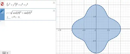

Here's a nice picture
Now the area is given by
$$\int_{0}^{2\pi}\int_{0}^{\sqrt{(\cos^{4}(\theta)+\sin^{4}(\theta))}}r\,dr\,d\theta=\frac{1}{2}\int_{0}^{2\pi}((\cos^{4}(\theta)+\sin^{4}(\theta))\,d\theta=\int_{0}^{2\pi}\sin^{4}(\theta)\,d\theta $$ . I'll leave the rest to you.
