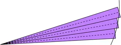

There are at least two way to look at this formula. The simplest, in my opinion, is approximating the area inside the arc into small circular arcs.
$\hspace{3.5cm}$enter image description here
The area inside each arc of radius $r$ and angle $\Delta\theta$ is $\frac12r^2\Delta\theta$ (this is proportional to $\pi r^2$ for the entire circle). Summing these approximations as $\Delta\theta\to0$ yields $$ \int\frac12r^2\mathrm{d}\theta $$

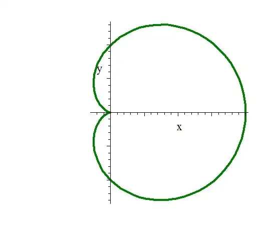

3. Area of a Cardioid. To compute the area of a cardioid with equation $r=4a\cos ^{2}\frac{\theta }{2}$ (see figure 2 below) we need to find the limits of integration. From the figure we see that $r\in [0,4a\cos ^{2}\frac{\theta }{2}]$ and $\theta\in[0,2\pi]$. The integral $(2)$ reduces to
$$\begin{eqnarray*} A_{\text{cardioid}}=\int_{0}^{2\pi }\left( \int_{0}^{4a\cos ^{2}\frac{\theta }{2}}r\ \mathrm{d} r\right)\ \mathrm{d}\theta &=&\int_{0}^{2\pi }\left( \left. \frac{r^{2}}{2}\right\vert _{0}^{4a\cos ^{2}\frac{\theta }{2}}\right)\ \mathrm{d}\theta\tag{$\ast\ast$} \\ &=&\int_{0}^{2\pi }\left( 8a^{2}\cos ^{4}\frac{\theta}{2} \right)\ \mathrm{d}\theta \\ &=&6\pi a^{2}. \end{eqnarray*}$$
Equation $(\ast\ast)$ corresponds to the formula in the question. Now $r$ is not constant, rather a function of $\theta$.
$$\text{Figure 2: cardioid }r=4a\cos ^{2}\frac{\theta }{2}$$
